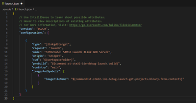

I am trying to debug my CubeMX (CMake/Ninja) project based on the STM32H7A3VG in VSCode.
When I use the elf-File in Ozone I can step through the code as expected. With VSCode the debugger seems to start, but no debugging is possible.
Other controller like STM32F446x or STM32F407xx I can debug with no problem.
I adapted the launch.json for the STM32H7A3VG and its M7 core also with the help of chatgpt but something is missing, I guess.
Here is my launch.json:
[2025-07-25T17:12:01.110Z] SERVER CONSOLE DEBUG: onBackendConnect: gdb-server session connected. You can switch to "DEBUG CONSOLE" to see GDB interactions.
"C:/programme/SEGGER/JLink_V854/JLinkGDBServerCL.exe" -singlerun -nogui -if swd -port 50001 -swoport 50002 -telnetport 50003 -device STM32H7A3VG -select usb=269302857
