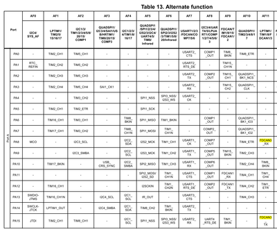

Using the CUBEMX tool I have used the alternate pins FDCAN3_RX to PA8 and FDCAN3_TX to PA15.
The GPIO init is pasted below. It fails to configure PA8 and PA15. Have I misunderstod something here? Is it set anywhere else?

2025-07-28 8:40 AM
Also the define
"GPIO_AF9_FDCAN3"
Is not found. Its almost like the CubeMX/code~generation is utterly ignoring the alternate functions
that are presented in the GUI

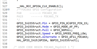

2025-07-28 9:03 AM - edited 2025-07-28 9:05 AM
They are initialized in the HAL_CAN_MspInit function.
Include your IOC if you're having issues.
VTOR is left at default. If you want it set, undefine the USER_VECT_TAB_ADDRESS define in the system_*.c file.

Pins are initialized in HAL_FDCAN_MspInit, as expected.

Why do you think AF9 is correct for these pins? It should be AF11.
