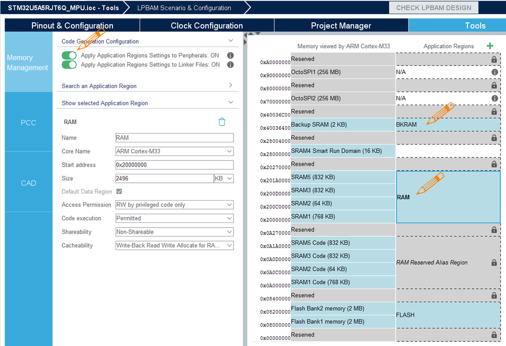

The cause was wrongly configured MPU (memory protection unit). In my project I added backup ram region to linker script via MX / Tools / Memory management tool. The linker script is updated only if both switches are set to on:
* Apply Application Regions Settings to Peripherals --> adds MPU settings to device configuration
* Apply Application Regions Settings to Linker Files --> updates memory regions in linker script xxx_FLASH.ld
Note: If you switch both switches off the configuration will not return back, MPU will not be disabled.

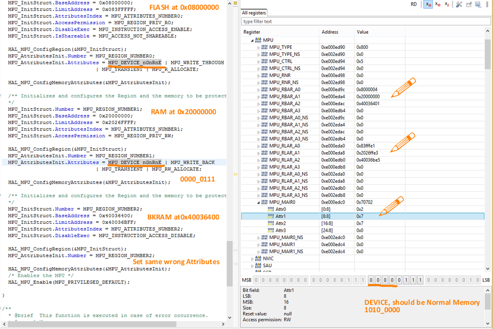

The problem is that MX wizard generates MPU settings for RAM regions with attributes set to DEVICE, not to Memory. The region with DEVICE attribute will generate HardFault (if not handled separately) on unaligned transactions.
DEVICE region attribute is 0000xxxx, Normal memory can not have attribute with zeros in upper 4 bits.
If you edit MPU MAIRx registers in debugger or if you modify initialization code in main.c the problem will dissapear.
