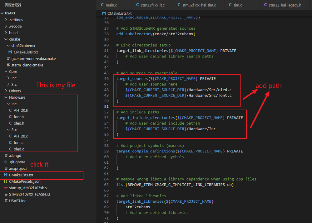

2025-10-12 1:09 AM
However, when you regenerate the project using CubeMX, any paths you added in the cmake folder will be overwritten.
