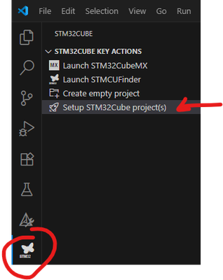

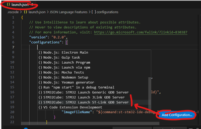

Brand new STM32Cube is requiring to update your launch.json and couple of extra stuff.
First have a chance to execute project setup what will help you later on:
Once ok let's ask for new configuration:
Is it helping ?
