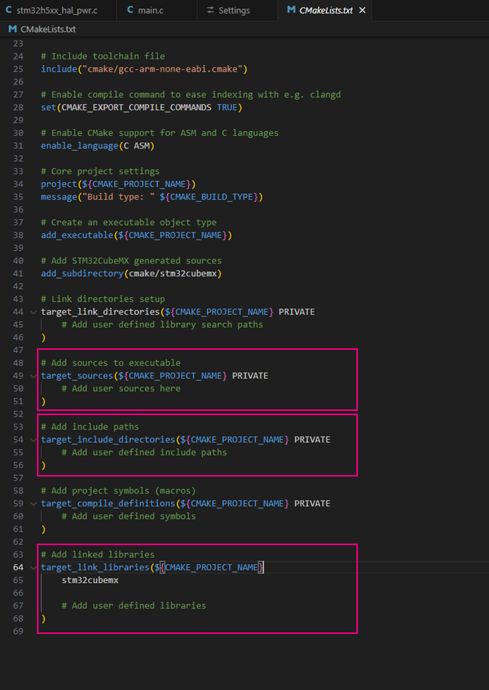

2024-11-01 3:36 AM
in target_include_directories: Add the path to the ssd1351 header files
in target sources, Add the path to the ssd1351 source files
target_link_libraries: links the library to the project
check: cmake-properties(7) — CMake 3.31.0-rc3 Documentation
2024-11-01 6:10 AM
c_cpp_properties is only for the editor so it knows where to find the header files and definitions so it can do proper syntax highlighting and suggestions.

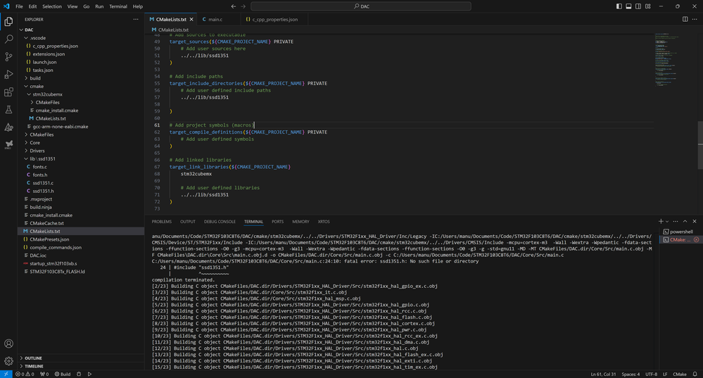

2024-11-02 12:35 PM
I can't make it work :
Plus, I updated SMT32CubeMX to version 6.12.1 and since, STM32F103C8Tx_FLASH.ld is not correct ! It miss the RAM processors and with a straight import in VScode using STM Code extension and using "import Cmake project", the compilation fail. I have to modify the STM32F103C8Tx_FLASH.ld file per hand and add the relevant and missing section :(
2024-11-02 1:06 PM
Are you sure "../../" is correct? That's two folders up.
2024-11-02 1:16 PM
I'm not sure, but I tried many, many possibilities without success. Even the absolute path don't operate.
Unfortunately there is no documentation about this...
2025-06-11 5:21 AM - edited 2025-06-11 8:13 AM
I am pretty sure that your folder should be:
${CMAKE_SOURCE_DIR}/lib/ssd1351I didn't try it with folders yet, but with single files it works like that for me.
