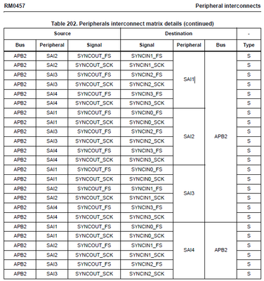

Here is for instance the SAI instance synchronization signals:
For Linux, a lot of information could be found in https://wiki.st.com/stm32mpu
I'm not sure Linux support natively in-between SAI instance synchronization: https://wiki.st.com/stm32mpu/wiki/SAI_device_tree_configuration (only inter block seems supported).
