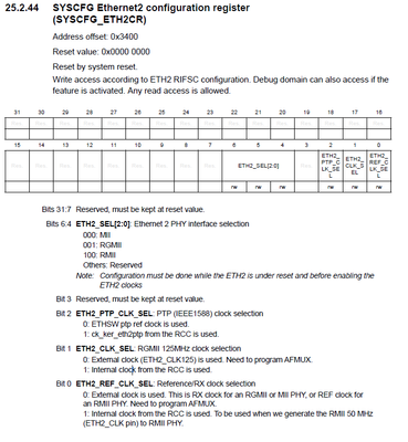

It was indeed ETH2_CLK_SEL that was set to 0.
But the reason wasn't the setup, it was the linux fork provided by Karo (the manufacturer of the module we are using) that for some reason patched out those lines:
if ((clk_rate == ETH_CK_F_125M) && (dwmac->eth_clk_sel_reg || dwmac->ext_phyclk)) {
dwmac->enable_eth_ck = true;
val |= SYSCFG_ETHCR_ETH_CLK_SEL;
into this:
val |= !dwmac->ext_phyclk * SYSCFG_ETHCR_ETH_CLK_SEL;
Reverting this change and keeping everything else the same now works.

Maybe double check the (dump) ETH2_CLK_SEL = 1 and ETH2_REF_CLK_SEL = 0 and ETH2_SEL[2:0] =0b001

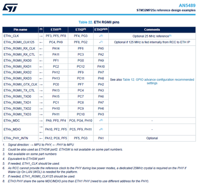

double check also pin choices (don't worry yet to GPIO advance configuration)
