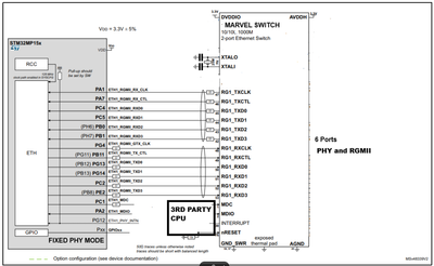

We have a Custom Board based from MB1272 dev kit.
Our system needs to connect the RGMII to a Marvell Switch Chip where that Switch is Managed MDIO from a different MPU.
As such we need our STM32MP157 MPU to run in a fixed phy mode and use the RCC to be its 125Mhz clk.
Please see simplified drawing
I have looked at the https://wiki.st.com/stm32mpu/wiki/Ethernet_device_tree_configuration#RGMII_with_Crystal_on_PHY-2C_no_125Mhz_from_PHY
but still confused as to how to do this
We have tried a few DT settings but no success,
would really appreciate some help on this one
Thanks

trying to help, maybe share more details of what's going wrong.
Any dmesg on the console to share ?
You should also define the 125MHz clock path in the DT.
https://wiki.st.com/stm32mpu/wiki/Clock_overview

Hi PatrickF
I have asked our dev team to try - check a couple more things
And will reply soon with Logs and DTs
Regards
Brett
