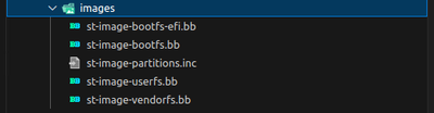

2025-06-22 5:55 PM
Thank you very much for your patient reply.
Perhaps my initial statement was not correct.
My goal is to create a new partition with my own custom content, so I tried to create recipes but encountered many problems. I wonder if my direction is incorrect?
