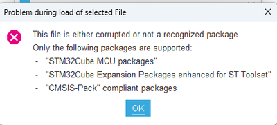

I have a custom board with stm32wba65 processor. I also have an RFM95 LoRa module. I need to add LoRaWAN capability. I tried adding I-CUBE-LRWAN into my CubeMX but was not able to load it (not a recognised package).
How can I get an ST or Semtech approved LoRaWAN stack into my project?
Please do not suggest I use stm32WL processor.

2026-01-21 3:24 AM - edited 2026-01-21 7:20 AM
Indeed, I-CUBE-LRWAN is not a "Package" in the CubeMX sense.
It's just a load of source code, which you add to your project manually. Or start from one of the supplied examples in it.

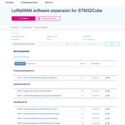

2026-01-21 7:28 AM
Hmm, there should be documentation on the Product Page - but it seems to be broken at the moment:
https://www.st.com/en/embedded-software/i-cube-lrwan.html#documentation
Is there a PDF included in the download?
2026-01-21 7:54 AM
I can see the documentation content:

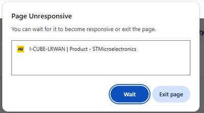

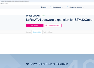

2026-01-21 8:06 AM
Not here - Win-11 Chrome :
Also on Edge
2026-01-21 8:17 AM
Same config but I don't have the issue! maybe you need to close Chrome and restart?
