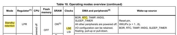

You can power the device normally and use low-power modes to modulate power usage. Look at the Standby Retention low power mode and see if it can reduce power consumption enough. Put the main power on a GPIO pin so you know when it disappears in order to switch to a low-power mode.
Will require some minor design expertise to draw from battery power only when main power is not present.
