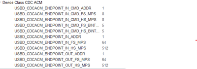

The point is : by default in X-CUBE-AZRTOS-WB we have this :
 and if i undestood corectly, ENDPOINT_IN_CMD_ADDR should be different of IN and OUT ADDR.
So i just modify like it :
USBD_CDCACM_ENDPOINT_IN_CMD_ADDR 2
