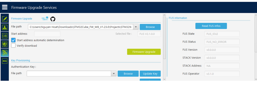

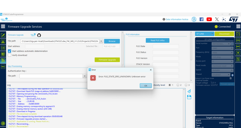

I’m trying to upgrade the FUS firmware on an STM32WB55 (specifically STM32WB55CGU6) using STM32CubeProgrammer (v2.20.0). However, when selecting the file stm32wb5x_FUS_fw.bin and starting the upgrade, I get the following error:
Error: FUS_STATE_ERR_UNKNOWN: Unknown error
System Details:
MCU: STM32WB55CGU6
Connection Mode: ST-LINK (SWD, Hot plug, Hardware reset)
Target Voltage: 3.23V
Current FUS Version: v0.0.0.0 (target file is FUS V2.1.0.0)

Log Output:
Download Stack/FUS image at address 0x08C00000
Opening and parsing file: stm32wb5x_FUS_fw.bin
Memory Programming...
File: stm32wb5x_FUS_fw.bin
Address: 0x08C00000
Erasing memory corresponding to segment 0:
Erasing internal memory sectors [203 208]
Download in Progress:
File download complete
Time elapsed during download operation: 00:00:00.648
Firmware Upgrade process begins...
Application is running, Please Hold on...
Reconnecting...
Reconnected!
