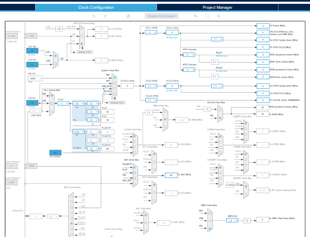

Okay, so it's doing, what you set it to do: nothing.
First, set clock tree to something useful...
SAI clock 48M, maybe ok, but core to max, I don't know now, maybe also 48M.
Now it's at 4.... this cannot do anything useful.
Then start it, maybe HAL_SAI_DMA_START(), or so. To the data array you want the data to get then.

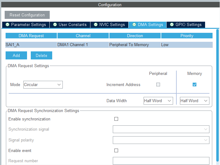

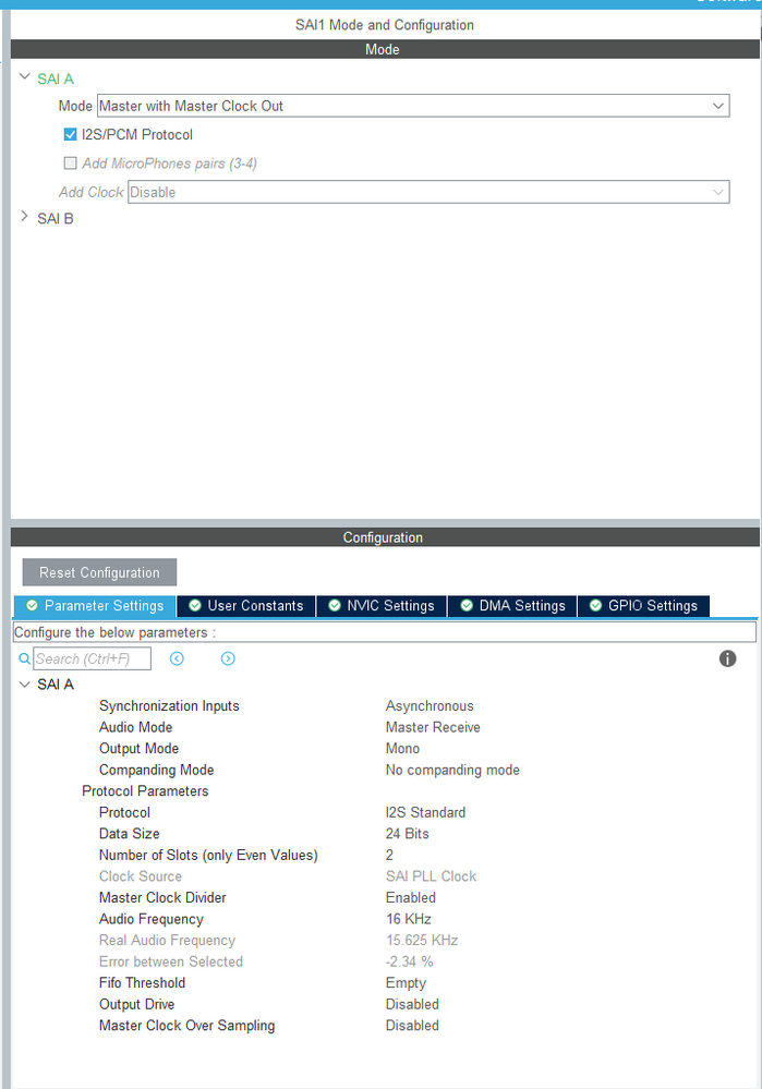

The SAI is working fine, just set it to the mode you need. Master receive, 16bit, two slots, ... maybe.
Then set a DMA Channel for circular mode, with 16b , half word, source and destination.

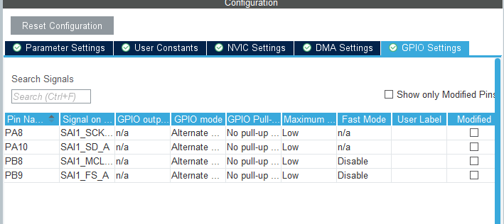

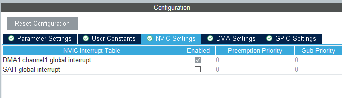

So starting from the bare minimum, here are the settings I tried in the STMCube configurator to get the INMP441 to work on the STM32WB55:
And the generated code (without any own code or comments) was this:

I overlooked the issue with the max clock, thanks I will try that.
I did let Cube auto set the clocks. Weird, for this simple setup I would trust Cube to be able to set usefull clocks....
2025-08-10 11:38 PM - edited 2025-08-10 11:38 PM
The Core Clock was the issue. I got it working now with 64 MHz. Thanks for spotting it.
