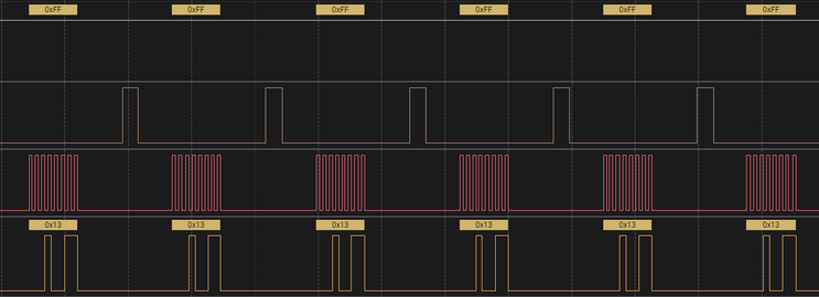

I can transmit data and can also verify with my logic level analyzer but the MISO line always stays high:

2025-07-17 8:29 AM
MISO is driven by the slave, not the master. What is it connected to?
2025-07-17 9:43 AM
It is connected to the internal LoRa-Transceiver (Semtech SX126x). I configured the physical pins only for debugging purposes. I know that the MISO is driven by the Slave, I just can't influence the physical wiring since the SPI is internally wired.
