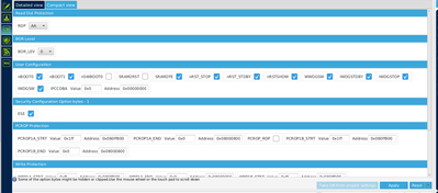

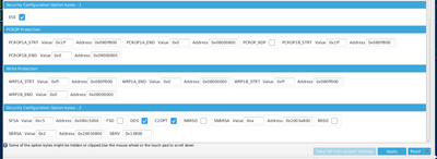

These are the option bytes:

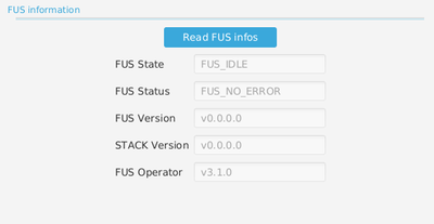

I tried to reenable the FUS by following these steps: Unable to start FUS. FUS version is 0.0.0.0 and FUS_STATE_ERR_UNKNOWN
Since most of the things mentioned looked almost the same. I attempted to toggle the RDP to BB apply it and back to AA, and momentarily it looked like it worked, but when I tried to update the wireless stack afterwards, it failed again and I wasnt able to make it work again.

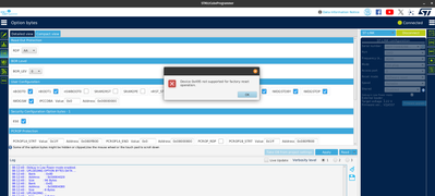

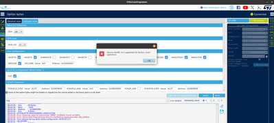

can you please try to reset the MCU to factory settings?
Best regards,
ST support

Hello, it took me some days to fully test it.
First, I used the initial StLink/V2 that I bought, it was a clone and I thought it failed because of it.
Then, I bought an original StLink/V2. Thinking that the ID Device was something related to the programmer. But it seems that it refers to the microcontroller version.
I kept on reading in some posts regarding how to restart the CPU2, using the address 0x5800040C to start the CPU2 and to try and make the FUS respond. But this yielded no results.
Also, now for some reason, the FUS is no longer reacting, previously switching the RDP value allowed me to attempt something, but now it doesn't return success either on Firmware delete or firmware upgrade.
