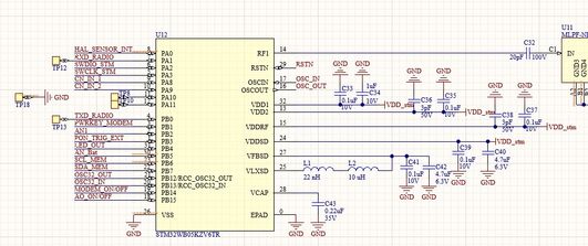

> custom PDB
What is the schematic?

This is the schematic:

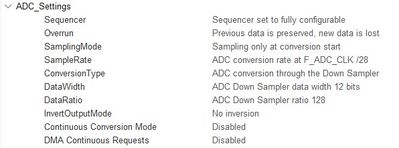

I was changed the sample rate from F_ADC_CLK /16 to F_ADC_CLK /28:
- F_ADC_CLK /16 I get 0,549V when the Vbat is 3V
- F_ADC_CLK /28 I get 0,675V when the Vbat is 3V

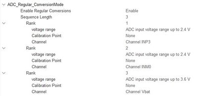

Can you share your IOC file?

Hello Ruben_EMI,
I am still getting familiar with the ADCs of the STM32 wireless series, but my practical observations so far are that when using "negative or minus" ADC input ports (I am see in VINM0 above), the measured value starts from 4095 and goes toward 0, i.e to get the "normal" value have to ectract measured from 4095, i.e.
adc_value = 4095 - adc_value;
Again, I am just starting with STM32W MCUs and I may be completely wrong, but it may worth to do few experiments at your setup and to confirm do you need to "inverse", the reading values or not...
