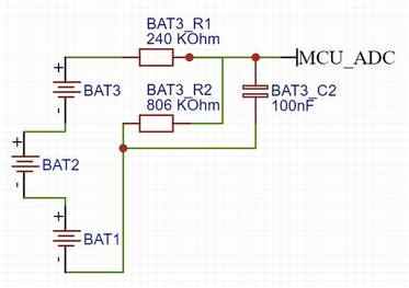

Regarding the total package voltage, a divider is required (because 3.6V/4.2V is greater than 3.3V). From what I could gather, I would go with a high resistance divider with a filter cap. I understood, that high ADC sample times would be required, maybe even taking multiple measurements and taking an average. The setup for measuring the total pack voltage would look like this:

The total divider has some issues:
A capacitor isn't required but won't hurt things. It's not an important decision here and there is no correct answer. I would not add one if it were my design.
- At 4.2 V battery voltage, output to the ADC pin would be 3.5 V, which is too high. Increase the 200 kOhm or reduce the 1 MOhm. The total impedance is about 1 MOhm which is about the max you'll get away with.
- The capacitor as you have it wired does nothing--both sides are connected to each other. It should be wired between the ADC pin and GND.
Oof. I made the mistake of calculating the resistor values with nominal cell voltage. I've updated the schematic in my original post. 240K and ~800K should give around 3.2V with 4.2V input. But now that I think of it again, I might change them a little more to have a bigger safety margin.

2026-01-10 5:17 PM - edited 2026-01-10 5:17 PM
Look up RIN for the ADC on the datasheet, it's probably in the 50 kOhm region, so adding another 10 kOhm isn't changing things but will reduce the injected current if the pin gets shorted to something outside of the range.
Consider making the board and then doing some tests with various components removed or changed to verify the accuracy is not significantly affecting.
