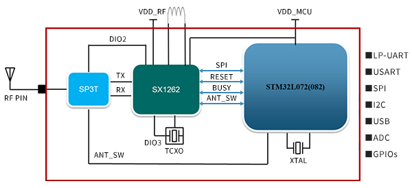

https://www.murata.com/products/connectivitymodule/lpwa/overview/lineup/type-1sj-686
Looks to be the same microcontroller (STM23L072), but with SX1262 instead of SX1276:
I-CUBE-LRWAN already claims support for "the new generation sx126x"

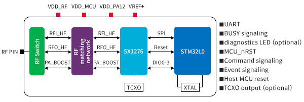

For reference, this is the block diagram the old Type ABZ module:
It seems that this is now NRND (Not Recommended for New Designs).
