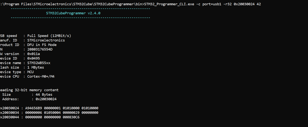

you can read the option byte IPCCDBA with st Cube Programmer, probably its 0x00 (offset), so you can read with stCubeProgrammer_CLi.exe the memory from the start of SRAM2a (0x20030000+IPCCDBA value(0x00), the first 42 bytes are device info table, located in SRAM2a start address , so execute:
STM32_Programmer_CLI.exe -c port=usb1 -r32 0x20030000 42, the you have te result.
Hope it helps
Regards
2020-03-20 1:48 AM
Sorry, i guess its like so, but i dont understand why FUS version seem to be 0x00000000, Ble Stack is working, and i didnt remove it.Wireless Stack version its in memory address 0x20030034

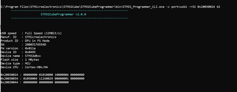

Finally solved it, i use St cube programmer to read Fus version, at first it returned FUS_ERROR, then i try again, and it returned the correct installed version, so i read device info table again via cli commands and everything seem to be ok, check it:

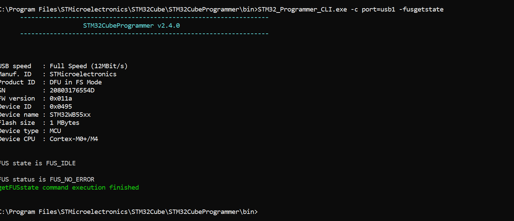

Hi again, i finally solved it, the reason why i read FUS version 0000 its beacause you have to send 2 fusGetSate commands, to activate it, then you can read the info, as described in https://www.st.com/resource/en/application_note/dm00513965-st-firmware-upgrade-services-for-stm32wb-series-stmicroelectronics.pdf PAGE 11.
I also did it via cli commands:
