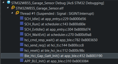

I am having trouble getting the BLE working on my new hardware. As a base project, I am using the WB55 Nucleo BLE_DataThroughput application. My new hardware is using a STM32WBCEU6.
Following the Release Notes in STM32Cube_FW_WB_V1.1.1/Projects/STM32WB_Copro_Wireless_Binaries I have created a bat script and have installed the FUS and BLE_Stack. (Batch File Attached)
The problem is when running my application code, the Ble_Hci_Gap_Gatt_Init() function does not complete as it is waiting for a CFG_IDLEEVT_HCI_CMD_EVT_RSP_ID event and does not timeout.
