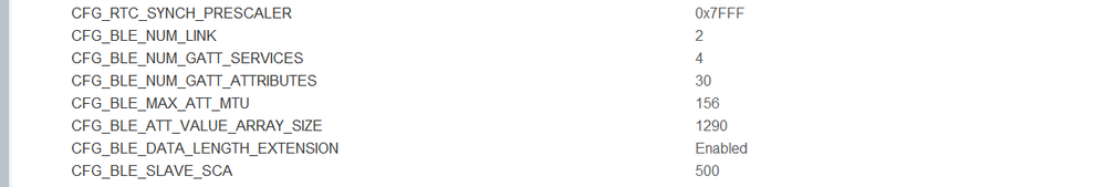

2022-02-11 9:58 AM
Hi there, first of all ty for you help WSH,
You were right, i'm using the stm32wb15cc so as you appoint there's a bad configuration caused by the cube ide configurator, inside the file app_ble.c line 302, the function SHCI_C2_BLE_Init( &ble_init_cmd_packet ) returns a 0x07 as you stated before, so the way i was able to fix it was changing some default parameters in the WPAN configuration tab, here's a snapshot of the most important IMHO, there are others but i guess these are the most important because the stack size, so any way, checking all the parameters against the examples of wb15cc can solve the problem :)
Regards!
