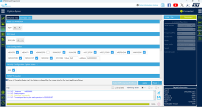

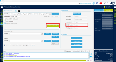

Firmware Upgrade Services Login

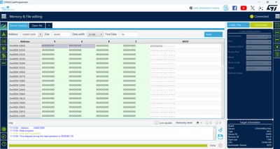

I verify in the memory address that the fus is found.
Pin configuration

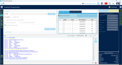

Now I am going to program the Wireless Stack but it fails to program.
LOG
16:47:20:713 : Opening and parsing file: stm32wb5x_BLE_Stack_full_extended_fw.bin
16:47:20:726 : Memory Programming ...
16:47:20:726 : File : stm32wb5x_BLE_Stack_full_extended_fw.bin
16:47:20:728 : Size : 184.18 KB
16:47:20:730 : Address : 0x080C5000
16:47:20:733 : Erasing memory corresponding to segment 0:
16:47:20:736 : fail @0xFEEEFEEE
16:47:20:736 : Memory Erase via FlashLoader!
16:47:20:737 : Memory erase...
16:47:20:764 : halt ap 0
16:47:20:786 : Erasing internal memory sectors [197 243]
16:47:20:786 : Init flashloader...
16:47:20:787 : halt ap 0
16:47:20:789 : run ap 0
16:47:20:789 : halt ap 0
16:47:20:789 : Loader sector erase...
16:47:20:799 : run ap 0
16:47:20:800 : halt ap 0
16:47:20:803 : Error: failed to erase memory
16:47:20:832 : Error: failed to erase memory
16:47:20:853 : RUNNING Program ...
16:47:20:854 : Address: : 0x080C5000
16:47:20:854 : STLink read from (0x080C5000) returned: 0x00000020
16:47:20:855 : 2nd try fail!
16:47:20:855 : STLink read from (0x080C5004) returned: 0x00000020
16:47:20:859 : 2nd try fail!
16:47:20:860 : Warning: The core is locked up
16:47:20:889 : Start operation achieved successfully

Could you try using the stm32wb5x_BLE_Stack_full_extended_fw.bin from the last version of the STM32CubeWB (V1.21.0). on the address 0x080C7000 (using the STM32CubeProgrammer V2.18.0).

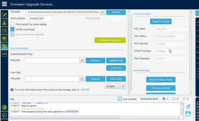

2025-01-23 11:30 AM

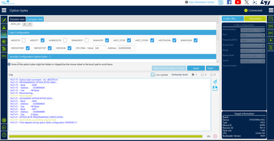

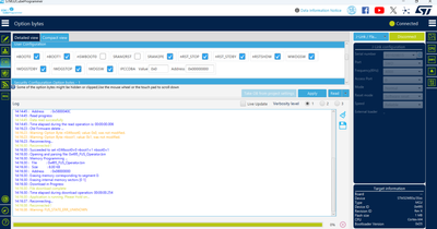

Hi, following your instructions Use STM32CubeProgrammer V2.18.0 and stm32wb5x_BLE_Stack_full_extended_fw.bin from V1.21.0.
Process used to program
2.programming
initially I try to program by firware upgrade but it changes the configuration of the nBOOT0 pins to check which causes it to send the program to 0x08000000.
14:14:45 : Time elapsed during the read operation is: 00:00:00.006
14:16:23 : Old Firmware delete ...
14:16:23 : Warning: Option Byte: nSWboot0, value: 0x0, was not modified.
14:16:23 : Warning: Option Byte: nboot1, value: 0x1, was not modified.
14:16:23 : Reconnecting...
14:16:30 : Reconnected !
14:16:30 : Succeeded to set nSWboot0=0 nboot1=1 nboot0=1

14:16:38 : Warning: FUS_STATE_ERR_UNKNOWN
trying to program from memory and files
I reconfigure the pins
I try to program but it does not finish executing the wireless stack.

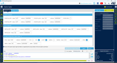

Have you activated accidently the anti-rollback feature. If so, the stack reference version is considered as FFFFFFFF (while no stack installed and anti-rollback is activated), so no firmware update is allowed after that, and no recovery is possible at this point.
This wiki is available for more details.
Best Regard.
STTwo-32
2025-01-24 7:31 AM

Could you try the same test on another board. Also, please send the values of all the option bytes for your Board.
Best Regards.
STTwo-32

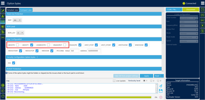

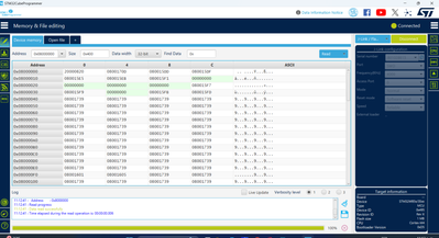

2025-01-24 8:21 AM - edited 2025-01-24 8:52 AM
I have 5 boards with the same customization, as I told you at the beginning, did not present any error but something made the BLE stopped working, as if the code was not executed.
Thinking that the error was due to deprogramming of the STACK and the FUS, we began to see the status of these looking if they were programmed.
When we tried to reprogram it, all this kind of failures started.
I have one card with FUS which is the one I am currently showing you and the others do not have FUS or STACK.
this is the pin configuration of another card
memory
