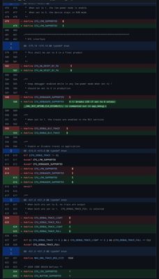

STM is fun isn't it? So user friendly.
I would check your DEBUG and LPM settings in app_config.h
By default DEBUG mode will keep the device awake. If low power mode is enabled it will automatically go into it's lowest possible power mode unless told otherwise.
Good luck
