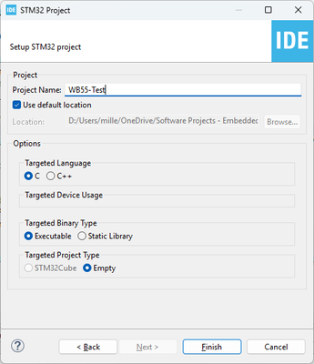

2025-07-22 8:13 AM
I'm not exactly sure what is happening, I upgraded to STM32CubeIDE v1.19.0 because when I created a new project, the .ioc file wasn't being created. Checked the forum and read that upgrading STM32CubeIDE would fix the issue, which it did. Today, I was going to create a new project so I could upload it here and now I'm back to not being able to create a .ioc file again.
Any insight?

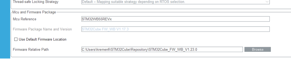

2025-08-09 12:31 PM - edited 2025-08-09 12:33 PM
I have attached a new project that I created using the, from an existing .ioc file menu. I tried upgrading to the WB firmware, 1.21.0 but for some reason it always downloads v1.17.3, no idea why it's doing that. I uninstalled v1.17.3 prior to upgrading to v1.21.0.
Current version of STM32CubeIDE is v1.19.0.
I'm very interested to know why it's generating app_ble.c code that seems to be incompatible and prevents the building of the project.
Any insight would be greatly appreciated.
Kindest regards.
2025-08-12 12:51 AM
can you please try to open the .ioc file in standalone STM32CubeMX and regenerate the project with version STM32Cube_FW_WB_V1.23.0? I have tried it this way and it worked on my side.
Thank you.
Best regards,
Filip Kremen

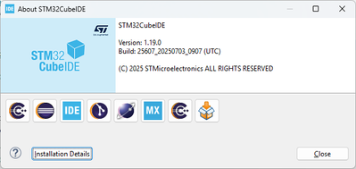

2025-08-12 6:08 AM
In fact, after installing the latest version of STM32CubeMX, I can't load ANY .ioc files in STM32CubeIDE. I had upgraded STM32CubeIDE via the STM32CubeIDE update process. I then manually downloaded v1.19 and installed it. Same thing, none of my .ioc files open now.
Kindest regards.
