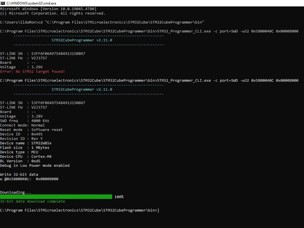

Hello, thank you so much for your support.
According to your advice - I used the next command
STM32_Programmer_CLI.exe -c port=SWD -w32 0x5800040C 0x00008000and it looks like that
Actually, I am not sure that "restore the device to its default state" was successfully performed since, via "STM32CubeProgrammer," I still see that data was not erased from device memory, and Stack and Fuse are still the same. Can you conform that it as ok?

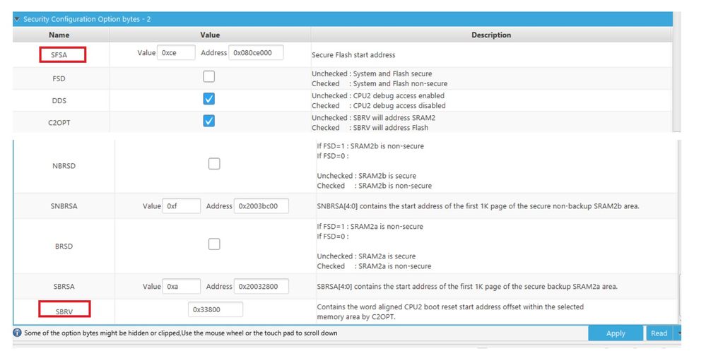

Also you can see details about the current status is here

2024-09-05 5:36 AM
Everything Should be fine. Could you give me a description of what you do for Stack and FUS upgrade (step by step if possible).
