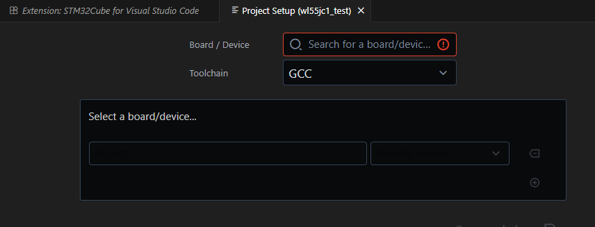

Sadly not as this morning I cannot re-create this error. Instead I get stuck at the project setup phase
What I'm doing is opening CubeMX, creating a new project based on the NUCLEO-WL55JC1 board. I select Single Core, all BSP hardware and generate demonstration code. Then within the Project Manager tab I select Cmake and give the project a name. Generate the code and then open the folder from a PowerShell window using 'code .'
Now the error above appears if I select yes to the auto prompt on opening the project as an STM32 one or if I use the "Setup STM32CubeProjects" via the Command Palette.
