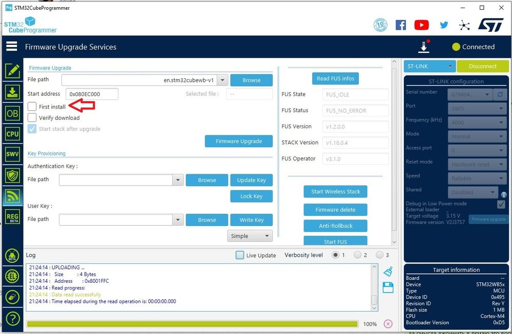

To start using BLE I need to upload the stack in STM32WB
As you can see in my attached image from the first message I did it but forgot to make a mark - "First Install"
and now No matter what I do ( full chip erase, reuploaded stake, removed stack, and installed again), Bluetooth doesn't work

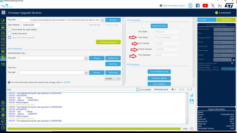

Yes, I did it many times, but my BLE is still not visible when I upload my .hex file
My .hex is correct I used him for a few years. But sometimes I have problems like that, if the first attempt stack file was unsuccessful after that I can't repair it.
I used the next register and FUS and Stack
stm32wb5x_FUS_fw.bin 0x080EC000
stm32wb5x_BLE_Stack_full_fw.bin 0x080CE000
probably I have some alternative for stack? or some a;tentative for STM32CubeProgrammer?
as an alternative I used
STM32_Programmer_CLI.exe -c port=swd mode=UR -fwupgrade "stm32wb5x_BLE_Stack_full_fw.bin" 0x080CE000 firstinstall=0 startstack=1 -v
but result the same
you can see my attached image from STM32CubeProgrammer, looks good, but BLE is not visible
