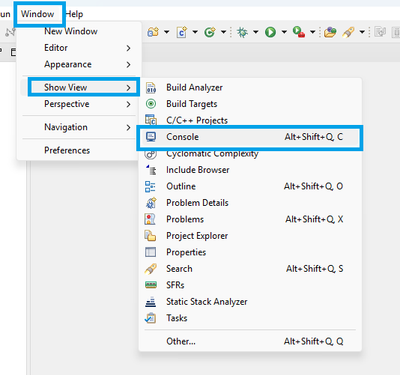

Is there an option in the STM32CubeIDE settings to reset to factory settings or something like “Default Settings”?
I can’t restore the console window to its original state. When I compile the code, the console window used to appear at the bottom, but now it doesn’t show up anymore.
2025-12-15 9:27 AM
2025-12-15 12:32 AM - edited 2025-12-15 12:44 AM
Try to activate it as the following:

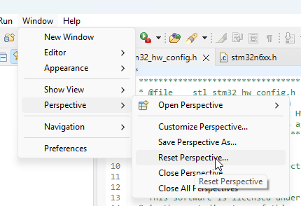

2025-12-15 9:15 AM
I know how to reactivate the console. But it opens as a separate window. However, when I first installed STM32CubeIDE, it did not open as a separate window.
2025-12-15 9:23 AM
Window > Perspective > Reset Perspective
hth
KnarfB
2025-12-15 9:27 AM
With the screenshot.
