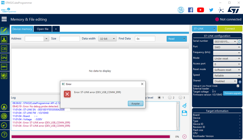

I tried that (with the boot jumper JP3 added and removed), and using all reset modes. I cannot really connect, and a bu error appears:
Thank you
