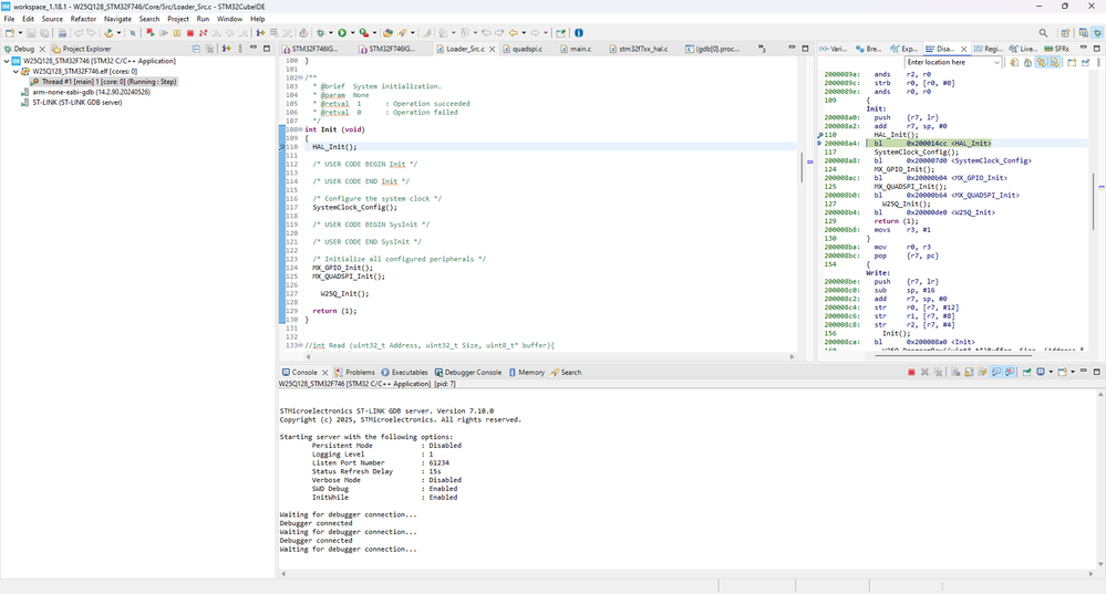

before stepin

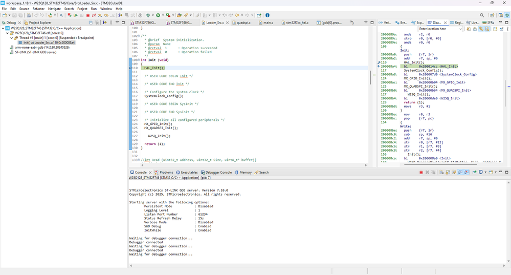

after stepin (debugger remains running)

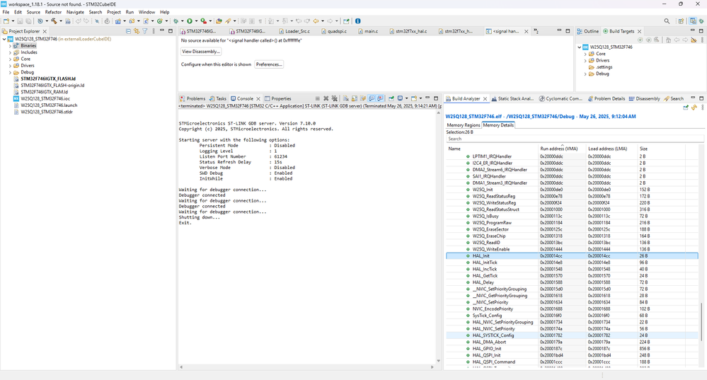

current binary memory details
that remarkable that the addresses are different of eg. the Function HAL_Init in Memory Details and Disassambler. Do you know how to get them equal? I need to run the functions from RAM.
