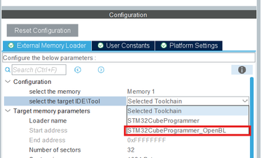

Hi @Hamady,
Both types of loaders can be generated by CubeMX. You'll have to change this option:
I also recommend checking this wiki Getting started with External memory Manager and External memory loader - stm32mcu for further details.
