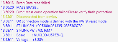

2025-05-07 5:04 AM
Hello @LouisB ,
I have now imported the .stdl file that TouchGFX has provided for the exact board + external screen combination. When trying to do a mass erase, this error occours:
There is no write protection enabled for the adress of the flash chip in CubeProgrammer
I am also not able to connect the board to ST-Link Utility and updated the board with CubeIDE to the newest ST-Link Firmwareversion
BR
2025-05-09 1:49 AM
Hello @Neyus,
Did you try to disable read protection option byte ?
BR,
