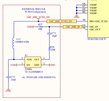

Hardware internals look alike this:

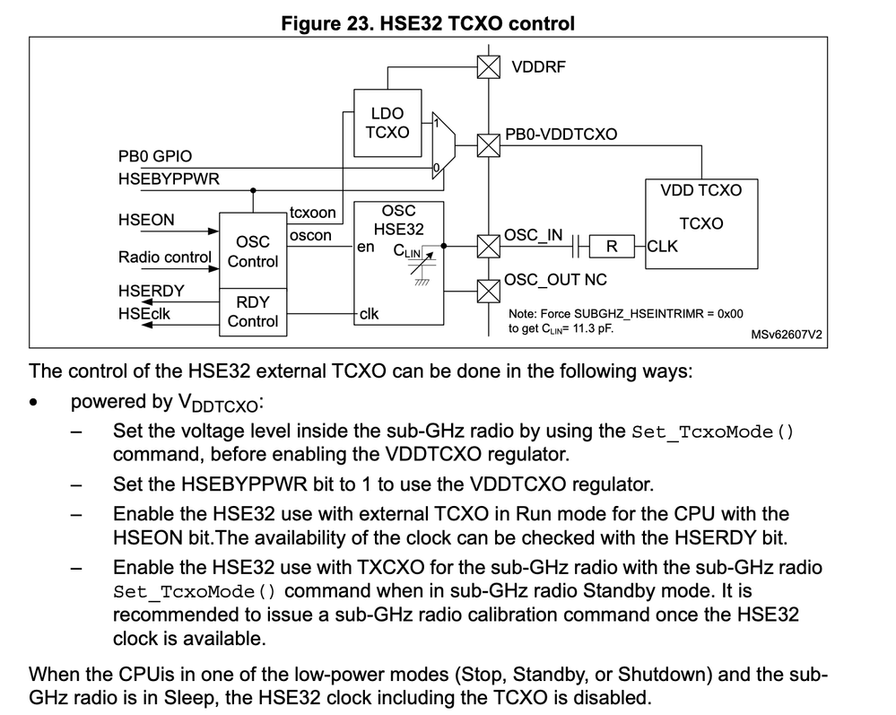

0693W00000WJMhIQAX.pngMy first thoughts were not in Radio component, but in communication with it.
Seems that this is working with SPI 4MHz and 2MHz and 512kHz correctly.
Calibration delay is also quick, somewhere in docs I have read few milliseconds.
I would say that calibration should not tolerate defunct TCXO.
But it goes through, as I experience it.
Maybe for calibration it is enough the internal 13MHz clock... don't know
Does not matter, I know, the path where it should turn on is missing something.
Maybe not in the init, maybe not in code but in procedure.
