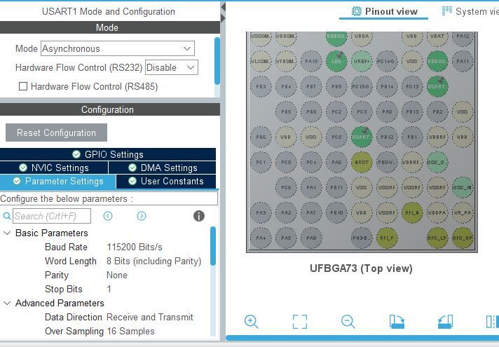

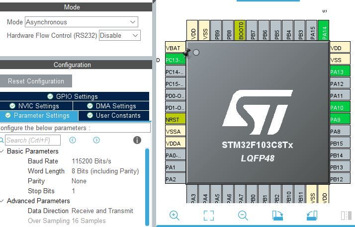

thank you for your reply
the clocks were wrong
i put 48Mhz on stmwl55jc2 and 72MHz on stm32f103c8t6 then uart worked fine
2021-08-08 11:18 PM
wl55jc has MSI, i used MSI clock
