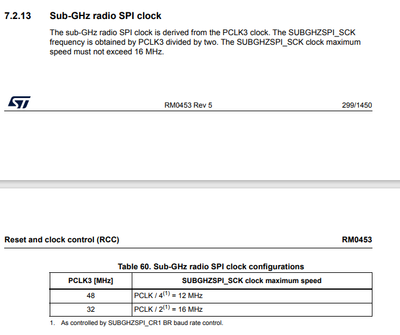

According to the RM0453, The sub-GHz radio SPI clock is derived from the PCLK3 clock. The SUBGHZSPI_SCK
frequency is obtained by PCLK3 divided by two. The SUBGHZSPI_SCK clock maximum
speed must not exceed 16 MHz. So, the baudrate prescaler value should be 4 or more in case PCLK3 clock is 48MHz or 2 in case PCLK3 clock is 32MHz.

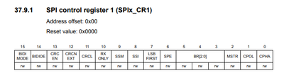

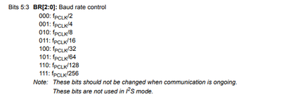

So, the baudrate prescaler value is the frequency divider value. it set exactly the 3 bits of the Baud rate control on the SUBGHZSPI_CR1:
Best regards.
Liltek Zina.

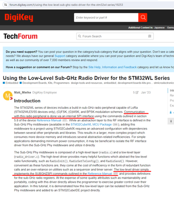

@Zayoud wrote:I used the pingpong sample code with the tutorial I have found in the TechForum: Link of the tutorial
That's DigiKey's forum - nothing to do with ST.
https://forum.digikey.com/t/using-the-low-level-sub-ghz-radio-driver-for-the-stm32wl-series/18253/11
As it says there, they're throwing away ST's standard code, and doing something "different" instead - so you'd probably be better asking the actual author there what it is that he's done, and how to understand & use his code!
