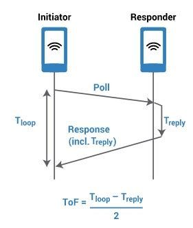

Was wondering if it is possible to measure the time on one just one board.
As an example, if I could measure the time for one round trip.
Transmitter sends a msg to the receiver and the receiver sends one back to the transmitter - Measuring this time on the transmitter.
Thank You
2023-12-29 2:18 AM - edited 2023-12-29 2:20 AM
You can do this but is going to be hard. You have to calculate the Time between the Poll and the replay as described here:
You may can use timer to calculate the Tloop and another one to calculate Treplay (and send it on the response message to the initiator). Then calculate the time of flight (TOF).
Best Regards.
