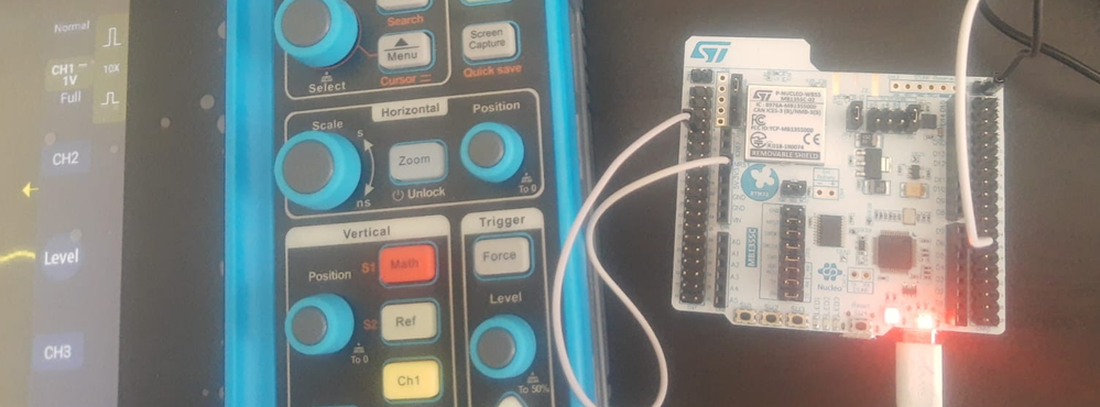

So im trying to follow the 1:20h tutorial about how to setup BLE,narrated by ringo start's voice and i reach the part in which he refers to an inexisting .pdf file containing the links for info about HSE calibration.
As cant find that .pdf he is referring to....

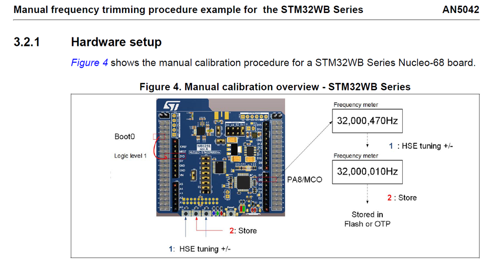

I am trying the manual configuration described in app note AN5042.

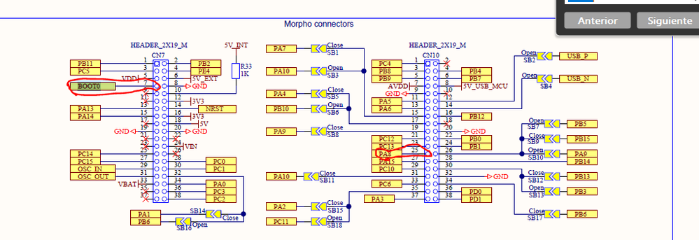

I checked the MB1355C schematics and pins should be ok
