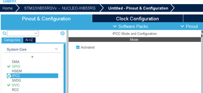

i am a beginner in STM32cube. i was working on board Nucleo wb55rg. and following this tutorial
STM32WB Getting Started Series: Part 12a, STM32CubeMX & STM32CubeIDE lab. Introduction, and it said on 2:33 that i need to activate "system core>IPCC and enable both interrupt". i am using STM32CubeIDE 1.5.0 and it does not show IPCC option on it .
any help and guidance is appreciated,
thank you

Hello @Shaawaiz and welcome to the Community,
You are using an older version of STM32CubeMX.
Please make sure to update and use the latest release of STM32CubeMX v6.17.0.
Thanks to keep me informed about your update.

2026-04-07 5:58 PM
thank you so much for the help. that was the case. just one correction: earlier i was not using STM32CumeMX, i was using STM32CubeIDE. the issue got fixed when i used STM32CubeMX version 6.8.1. thank you so for your help :)
