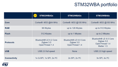

Hi @Imen.D ,
Thank you for your response. I would like the MCU to support both BLE and USB functionality. Currently, only the WBA2x and WBA6x series meet these requirements. Considering functionality and cost, the WBA2x appears to be the preferred option. The only remaining concern is the RAM size. To mitigate this risk, I plan to design and fabricate a test board to evaluate overall system stability.

Hi @CY_Tsai ,
You are right. Both STM32WBA2x and STM32WBA6x series support BLE and USB:
STM32WBA2 wireless MCU series overview
Regarding the RAM size, validating with a dedicated test board is the correct approach. This will help ensure the application fits within constraints and allows you to assess RAM usage.
