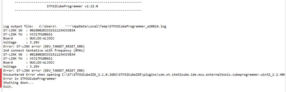

I've reproduced the same behavior with CubeIDE 2.1.0 with NUCLEO-WL33CC1 board:
Issue, escalated internally for investigation. Internal ticket for follow-up: CDM0061070
I'll get back to you as soon as I have a feedback.
I did the same test with IAR and didn't get any issue.
