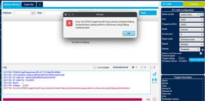

I bought ST-LINK/V2 from a certified reseller, and I have WIO-5E mini with STM32WL5JC from [Seeed.com](https://Seeed.com) on the board. This WIO-5E was already programmed by another ST-LINK/V2. I connected WIO-5E to ST-LINK as required. I want to reprogam WIO-5MINI using this programator. But STM32Programmer answered:
What should I do so STM32Programmer will see STM32WL5CJ from the WIO-5E mini board?

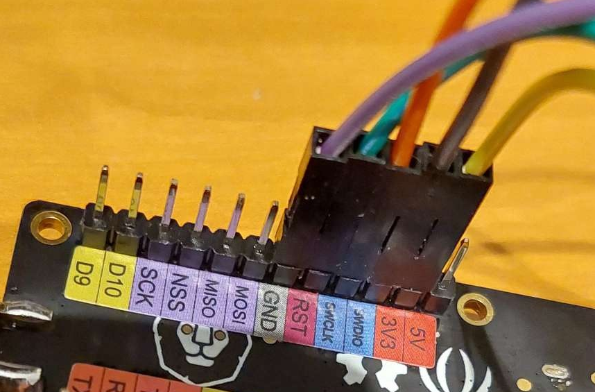

Steps to attach WIO-5E mini to ST-LINK.

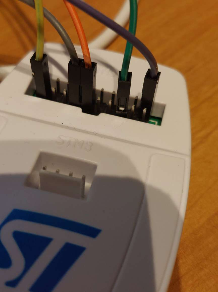

Wire connections:
ST-LINK
1 => VCC
7 => SWDIO
9 => SWCLK
15 => NRST
20 => GND
WIO-5E pins mini should be connected to pins with the same names as for ST-LINK.

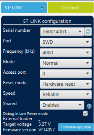

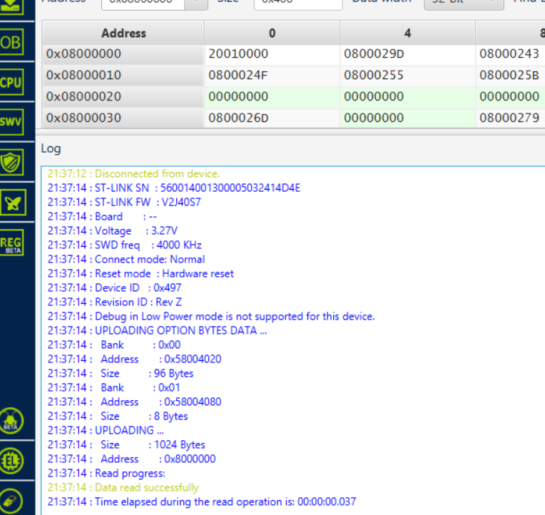

Open the STM32Programmer, press the button Connect (look at settings before)
You should see the following response (without another serial number for the ST-LINK).

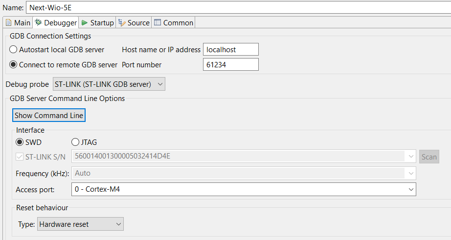

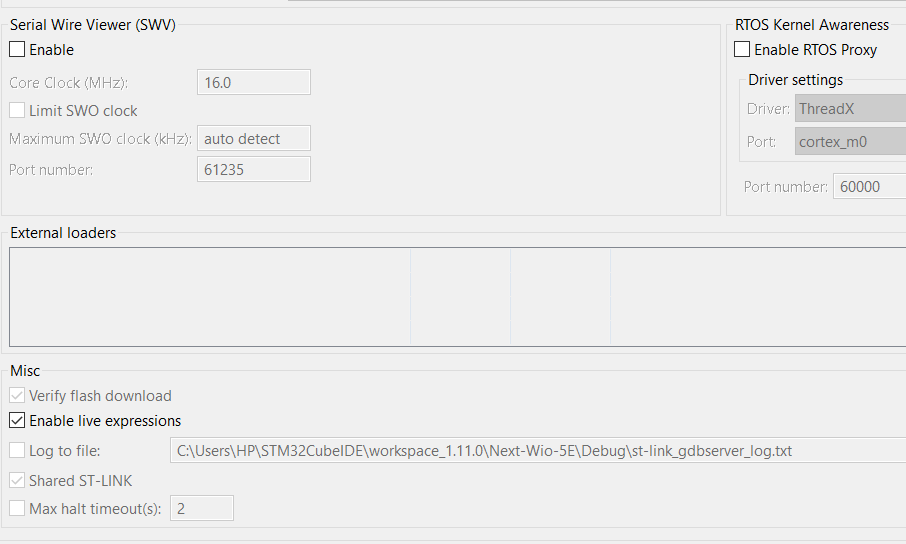

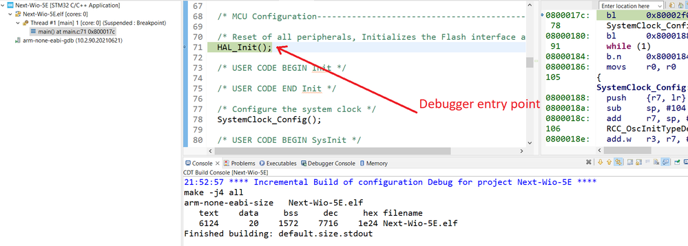

So next, run STM32CubeIDE, go to option Run => Debug configuration, switch to de Debugger tab.
Do the following steps:
And finally:
The end of the story.
PS. Next time, when you will try to debug, don't forget about point 3 from the above list.

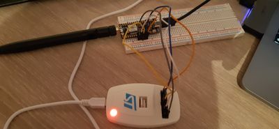

Hello everyone , i followed up the conversation after a week of research i can't fix my problem.
here my setup :
here my logs:

How can i reboot to the builtin state.
Impossible for me to connect back with my stlink v2.
Can someone help me to find out my problem many thanks in advance.
