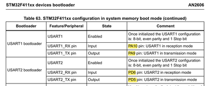

Here are the two pin configurations listed in AN2606 as supported:
If you don't have PD5/PD6 on your chip, you can't use those, so PA9/PA10 are the only ones available for you.
> I've checked uart1: PA10 PA9 -> it works, bootloader starts!
Good! Shows things are working as expected.
> uart2: PA3, PA3 -> doesn't work
PA3 won't work as it isn't listed in AN2606.

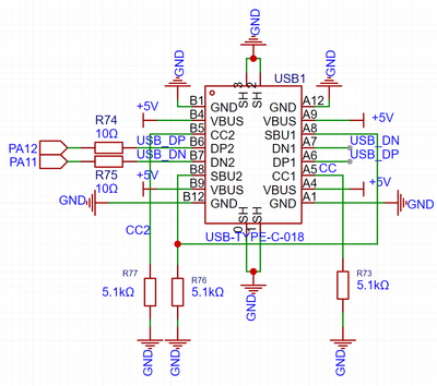

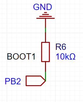

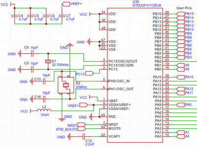

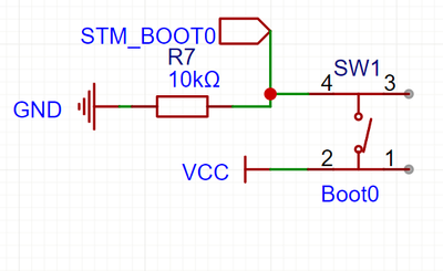

After trying to launch the bootloader, you can then connect with STM32CubeProgrammer over SWD and example the PC register and confirm it's 0x1Fxxxxxx.
> I received no answer on both uarts after sending 0x7F.
Which UARTs and pins? It's not shown in your pictures. Are they listed as supported in AN2606?
Schematic seems workable. It has minor issues which I don't believe will cause issues for basic bootloader functionality:

However, it is still not clear to me why the USB boot does not work. I have installed all stm windows drivers. on the black pill board, the bootloader is displayed as “STM Bootloader” in the device manager as expected. on my custom board, “unknown usb device device descriptor request failed” is displayed
The bootloader works with uart. Are there any mistakes in the schematic? the HSI starts, but not the external ... are there any requirements I missed?

Does HSE start in a user program? If not that’s the issue. What observation makes you say that it doesnt start?
There are some comments in AN2606 about lower clock HSE such as 8 MHz being preferred.

Yes, HSE starts in user program. My observations are, that the HSE doesn't start if I press BOOT0=1. As I read in the docs, the HSI tries to start the HSE und changes system clock. After that the USB description is sent. But there seems to be a (hardware) failure in my board as the usb description fails (windows said).
2025-03-25 8:16 AM
Did you try with another crystal ? try "standard" 8MHz , or 16M crystal.
