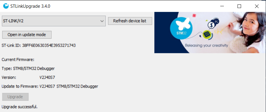

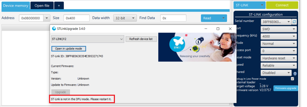

2023-02-06 9:44 AM
@Peter BENSCH
I upgraded the firmware with a stupid trick. I unplug the USB cable from ST-LINK, count for up to 6 sec, plug the USB into it, count again for up to 6 sec, and press on upgrade firmware button.
Firmware upgraded to the requested version.

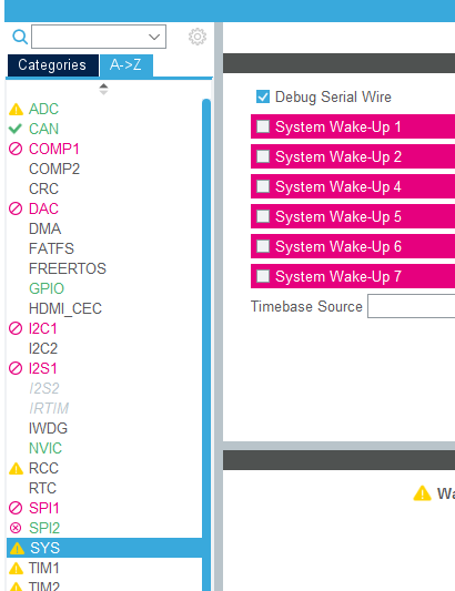

so just look, what you set in option bytes. there is something , that disables SWD , i suppose.
or in your program -> using the SWD+SWC pins for something, change their mode;
+ you set in Cube : SWD ?

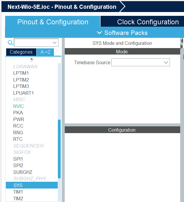

2023-02-07 5:33 AM
@AScha.3 Here is my view:
It looks completely different from your's view.
But I can't understand the relation between the configuration of an application and trying to connect ST-LINK to WIO-5E mini (with STM32WL5JC chip on the board)
2023-02-07 6:26 AM
ok, (pic was from F072 cpu) , on your WL5x cpu the relevant pins can be set to different functions, if you want SWD debug connect, you must set PA13 + PA14 to SWD+SWC function. otherwise they will do, whatever is set to them.
if you just want flash/load program, maybe you should try bootloader mode and flash this way.

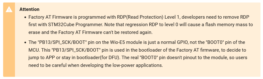

2023-02-07 7:15 AM
Yes, the firmware was cleared, and the protecion level was set up to AA. After that, I might upload code (.hex) to WIO-5 min. In the beginning, I would ask the chip using AT commands. After clearing the firmware, it's obvious that I can't ask with AT command. But I might program this chip. I saw that WIO-5 contacts to Chirpstack gateway.
