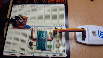

upload_protocol = stlinkMy setup consists of a very basic breakout PCB for the MCU:

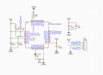

Which is roughly hooked up as follows:

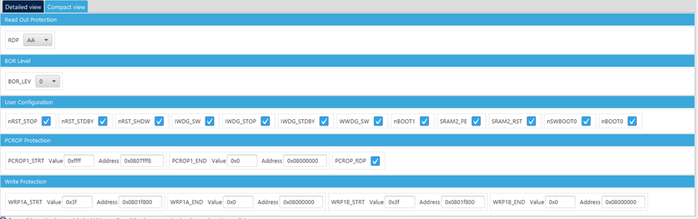

shutdown command invokedAnd the config flags in STM32CubeProg:

The loop Chip VDD/Pin1 via C1 to chip VSS Pin32 seems large. Insufficient decoupling may lead to inconsistant behaviour.
Better do your first experiments with Nucleo boards, as they have all the infrastructure needed.

Compared to the reference schematics in " Getting started with STM32L4 Series and STM32L4+ Series
hardware development" App. Note: NRST does not have a pull-up R. NRST is a bidir pin which is pulled down from inside on reset. You may monitor NRST level with a scope.

dear @JesFo
Indeed Reset circuit should be updated , please remove R1 and R2 resistors .
Cheers

Terribly sorry for the late reply. I've removed R1 and R2. Should I bridge NRST to high or low? Or should I leave it floating now that the resistors are removed?
2025-05-26 12:08 AM
I've completely disconnected NRST from anything. Probing it with a scope shows it rises to 3.3V when powered on.

NRST needs a capacitor for "temporization", so that everything is already set up when reset releases. The capacitor will also inhibit short noise pulses on NRST
2025-05-26 10:20 PM
I have 100nF across NRST and ground.
