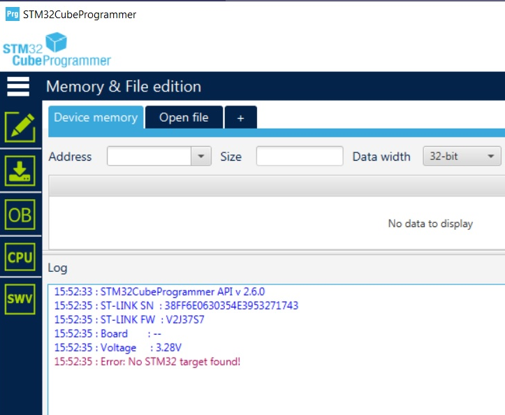

I bought ST-LINK/V2 from a certified reseller, and I have WIO-5E mini with STM32WL5JC from [Seeed.com](https://Seeed.com) on the board. This WIO-5E was already programmed by another ST-LINK/V2. I connected WIO-5E to ST-LINK as required. I want to reprogam WIO-5MINI using this programator. But STM32Programmer answered:
What should I do so STM32Programmer will see STM32WL5CJ from the WIO-5E mini board?

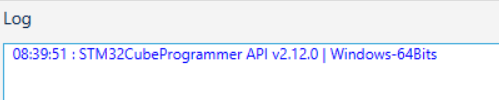

I upgraded to the latest version.

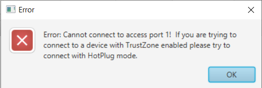

Then I tried to connect with normal mode and I get the message
When I changed to HotPlug mode and pressed the Restet button on the WIO-5E mini, the programmer responded with several messages:

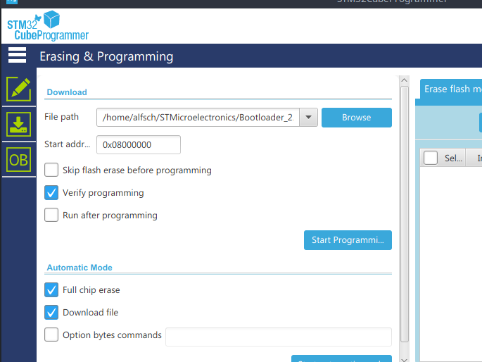

now click download symbol and select xx.bin file, you want to flash:
