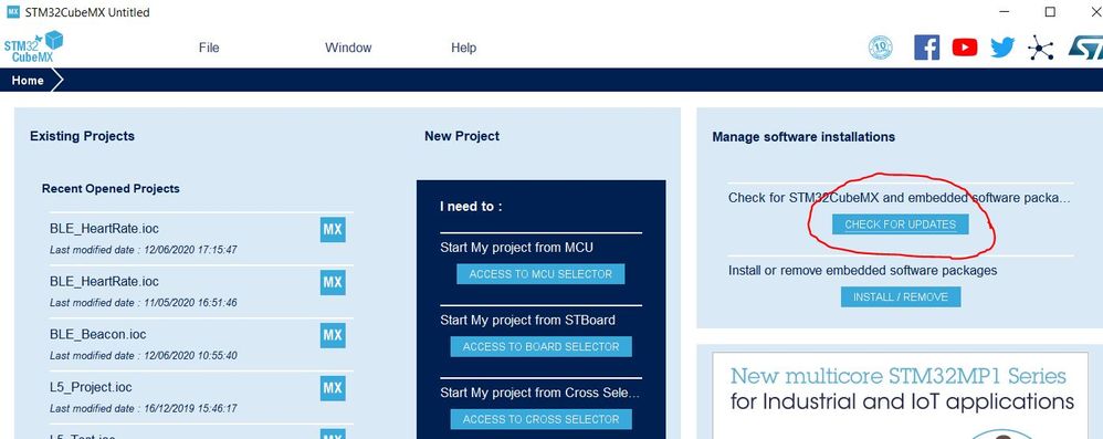

The usual way to start a project is to use CubeMX tool. You can check for any CubeFW package update each time you want to configure your project. (see picture below)
