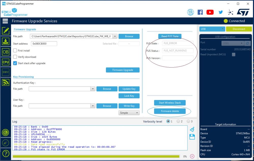

I switched ON the system. When I read FUS state, I got this error (image1). I plugged the power off to the Nucleo board by removing both the USB connectors (ST-Link and user USB), plugged again. This time when I read I get no error. However the green LED does not blink. Yesterday I used the "Firmware Delete" key to delete the BLE stack and programmed it again.
2020-10-27 9:01 AM
At the time you plug the board, the FUS is not running. You need to activate it to get its version. As mentioned in AN5185, you may have to call the FUS_GET_STATE command twice before getting the result. The “READ FUS STATE�? button is issuing this FUS_GET_STATE command. If you press it twice, you will get the information displayed for sure.
Use the programming sequence I exposed above and it should be OK.
2020-10-27 10:05 AM
Thank you so much Remi QUINTIN. I shall do as advised.

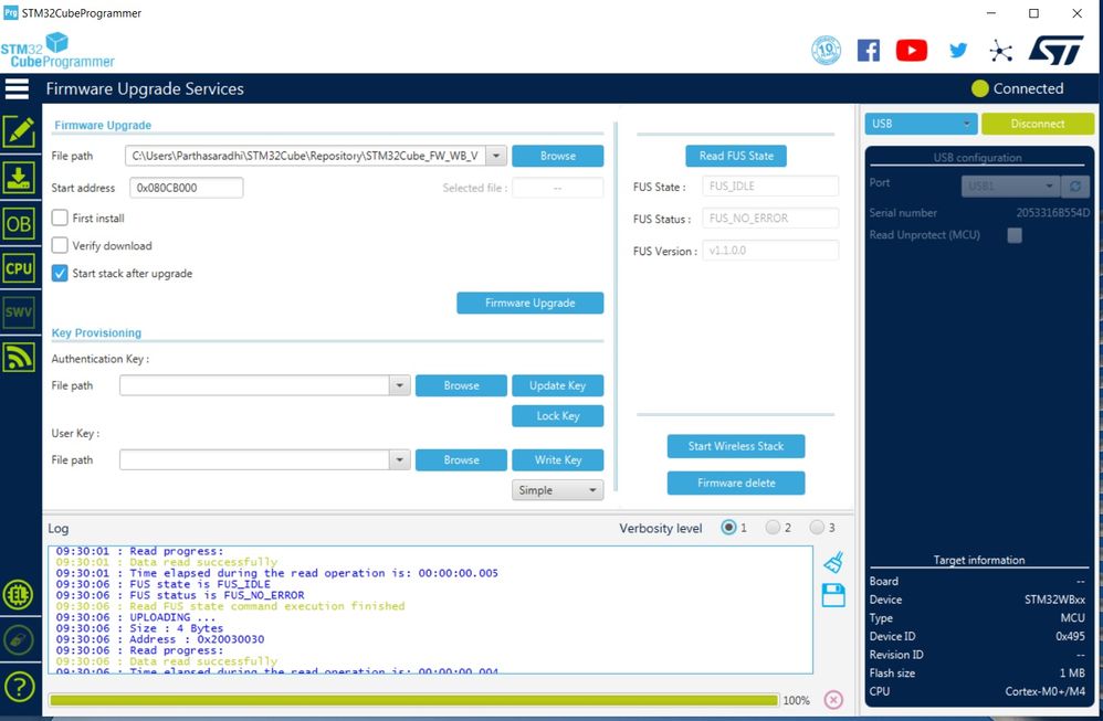

Help needed please. This is driving me crazy. Looks like everything is in order but the sample application is not running. I am trying to program the Nucleo board (not the dongle). I have been able to load V1.1.0.0 FUS. Thereafter to load the RF stack steps followed:
Except reloading the FUS V 1.1.0.0, I tried loading the RF stack and the application program more than once. When I read the FUS status it shows IDLE most times. Is this correct (if RF stack is running FUS must be stopped. Right?)
What am doing wrong in the above steps?
Thank you for your time.

2020-11-02 8:58 AM
Did you remove the jumper used to set PHY/BOOT0 to 1? to boot from main flash.
Yes start a new thread if the issue is not solved with this check.
2020-11-02 9:22 PM
Hi Remi QUINTIN,
Thank you very much. You hit the bulls eye!!! Yes I missed the jumper, but then the "run after programming" is ticked, hence did not really bother to check with the jumper setting. Sorry to have disturbed so very often and hope not to trouble you further. Best regards
