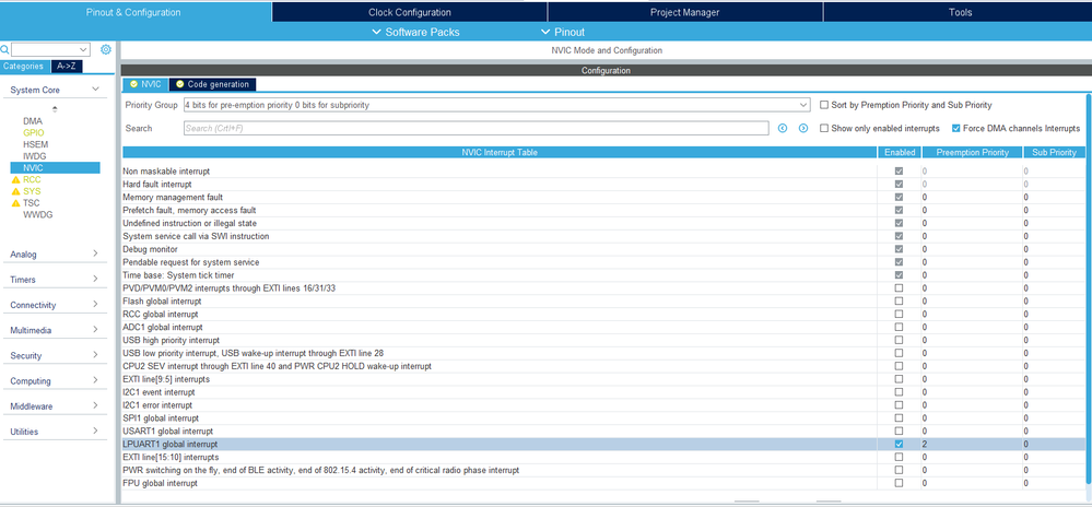

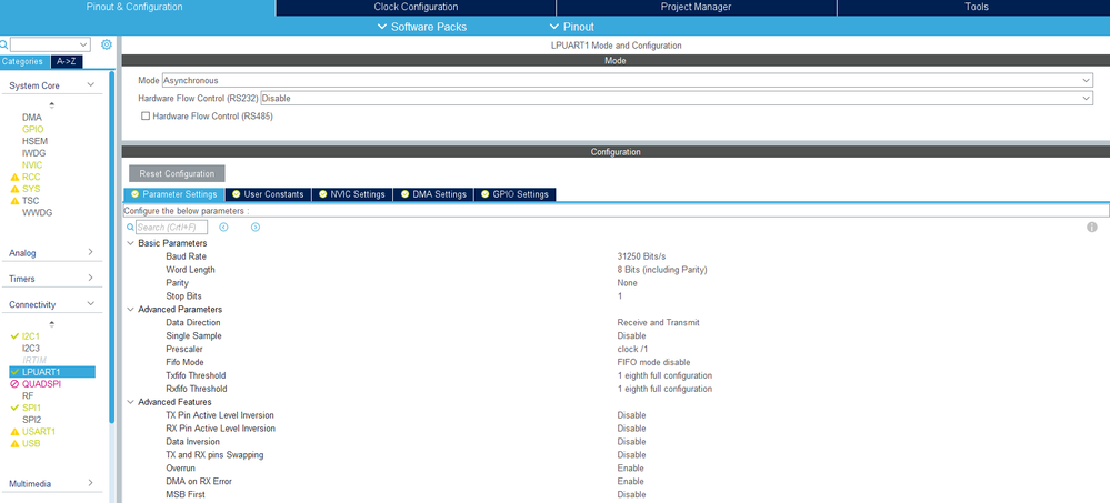

Full disclosure, I did use the *.ioc file to setup most the parameters so it could be a setting issue in the *.ioc file. Regardless, here's my initialization function (if it helps):

}As I mentioned above, I removed most the initializations (clock, other peripherals, etc) for readability purposes so if I'm missing something else crucial here that might help resolve this, let me know and I can easily post the full code!

}It didn't make it to that unused portion as well. Based on this, all signs seem to suggest there's an issue with setting up the NVIC for the UART, right? Not sure what else it might be if it's not opening up either of these. There aren't really too many settings to setup though so I'm a bit confused as to why that might've caused the issue . . .
Am I missing something?
